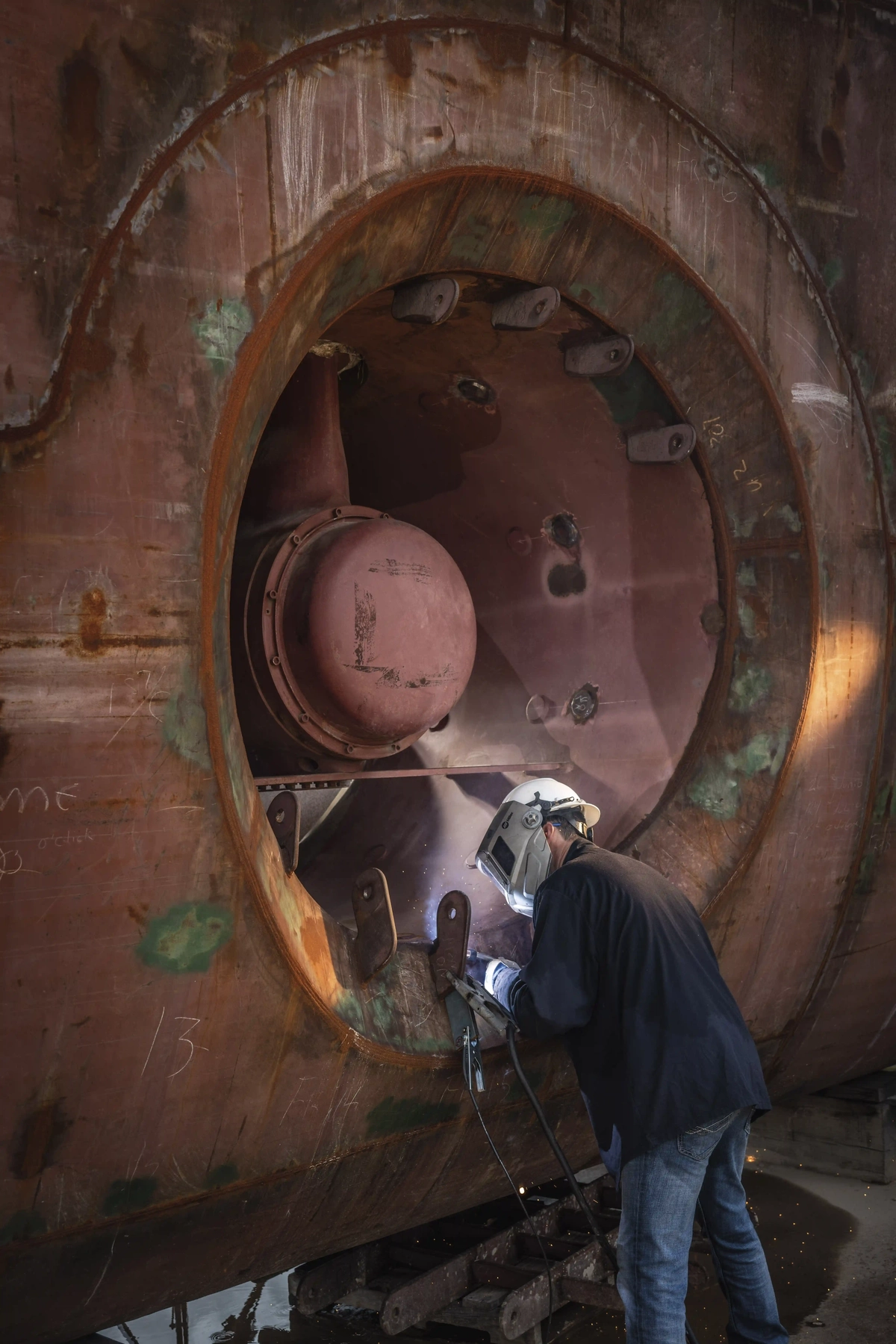

Shipbuilding goes beyond structural welding of the ship and includes the intricate work on HVAC systems, piping, and other internal components.
