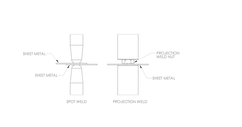

1. Are you making a spot weld or projection weld?
Is this a spot weld, or is it a projection weld (typically a weld nut or a weld stud)? Spot welds require electrodes with a distinct weld face to control the size of the spot weld itself, while projection welds require larger flat electrodes to support the workpiece(s) and/or the nut or stud. Special electrodes are available for projection welding nuts and studs — Fig. 2.
WD July 2025 - Recommendations for Selecting Spot Welding Electrodes - Fig 2.webp
Fig. 2 — Spot weld vs. projection weld.

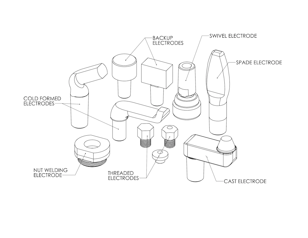

3. What nose should I use?
There are six standard electrode noses for spot welding electrodes for various spot-welding applications. The different noses are available in a variety of weld face sizes — Fig. 3. Noses can be paired for general spot-welding applications or mixed to achieve various requirements. Here is a list of common examples when different nose profiles can be useful:
  • Prevent surface damage on Class A welds. Use a C nose or flat face.
  • Break tough oxide layers on aluminum welds. Use a F nose or radius face.
  • Control the weld nugget location in spot welding different thicknesses of material. Use different diameter weld faces.
  • Weld in a tight space, such as a corner or flange. Use a D nose or an offset face.
WD July 2025 - Recommendations for Selecting Spot Welding Electrodes - Fig 3.webp
Fig. 3 — Various kinds of noses are shown.

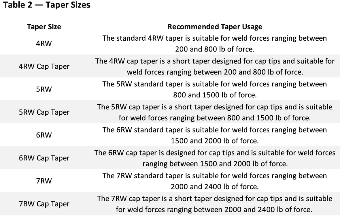

5. How will the electrodes be mounted?
The majority of resistance welding electrodes are usually held in their electrode holders with a friction taper fit. The tapered fit electrodes can be easily removed and have internal holes for cooling. Electrodes are also available with thread mounting. Specialty electrodes can be held with clamping mechanisms or retainer nuts where machine clearances don’t allow traditional electrodes to be installed or where welding forces would otherwise make tapered or threaded mountings impracticable. You want to select electrodes compatible with the current tooling and weld forces. Table 2 shows weld force ranges for the RWMA tapers.
WD July 2025 - Recommendations for Selecting Spot Welding Electrodes - Table 2.webp

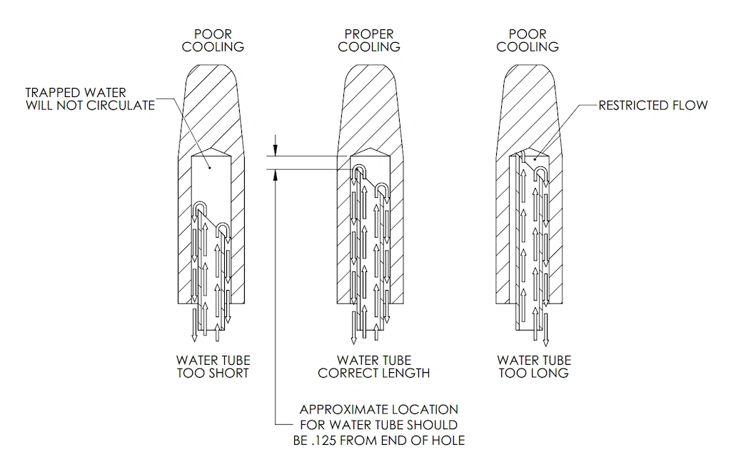

6. How will the electrodes be cooled?
Proper cooling is the best way to maximize electrode life. Electrodes should be cooled with clean water at a rate of 0.5 to 1.5 gal/min — Fig. 4. Select electrodes and holders with water tubes that will sit approximately 0.125 in. below the bottom of the electrode.
WD July 2025 - Recommendations for Selecting Spot Welding Electrodes - Fig 4.webp
Fig. 4 — Water tube location.

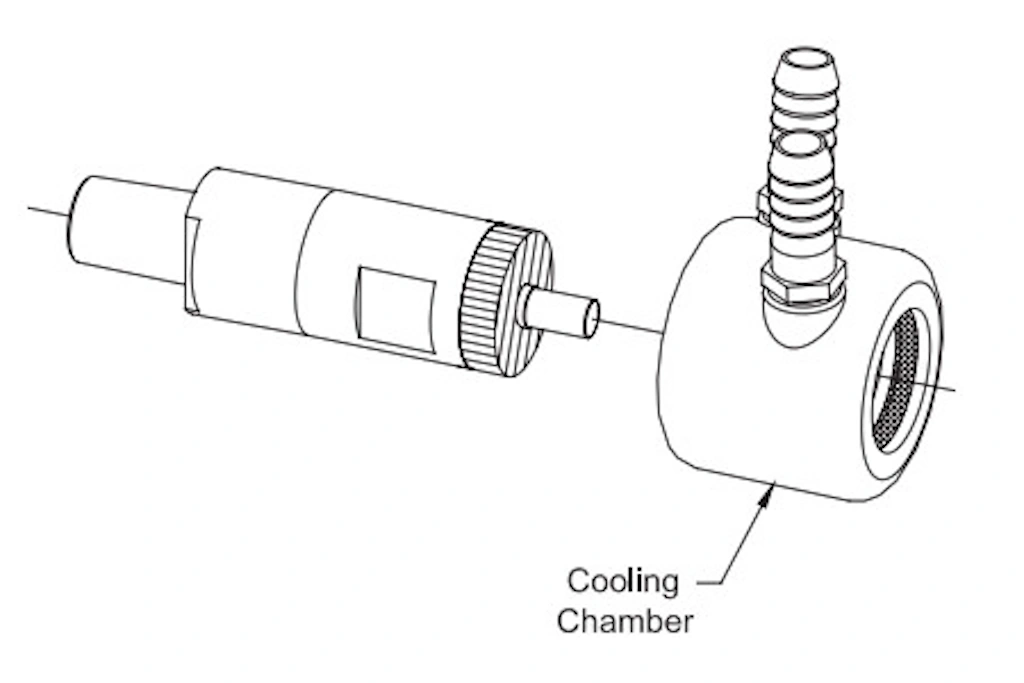

For certain applications, such as projection welding, it may not be practical to cool the electrodes internally with water tubes. In these cases, investigate a water-cooling jacket that mounts to the exterior of the electrode — Fig. 5.
WD July 2025 - Recommendations for Selecting Spot Welding Electrodes - Fig 5.webp
Fig. 5 — Cooling chamber.

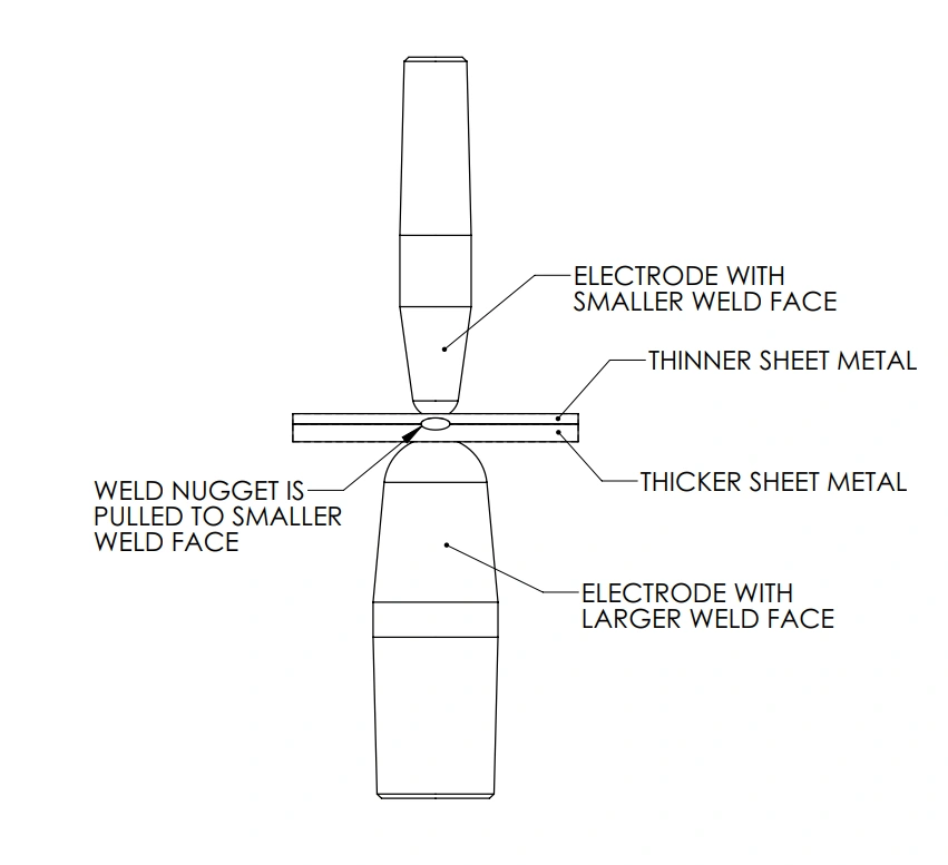

7. Do you have dissimilar materials or metal thicknesses?
When welding dissimilar materials or metal thicknesses, there will be differences in the resistance of the workpieces to be welded — Fig. 6. The smaller weld face generates more heat; thus, shifting the weld nugget into the thinner sheet. When using the same electrodes to weld two different material thicknesses, the weld nugget will be biased toward the thicker sheet, because the thicker sheet has higher resistance. To shift the weld nugget toward the thinner sheet, it is recommended to use a larger weld face on the thicker sheet. This will reduce the current density and increase the heat dissipation on the thicker sheet. The same result could also be accomplished using an electrode with higher resistance on the lower sheet. The goal with heat balancing is to utilize the electrode material or weld face diameter to compensate for differences in the resistance of the workpiece. You want the weld nugget to penetrate the two workpieces evenly.
WD July 2025 - Recommendations for Selecting Spot Welding Electrodes - Fig 6.webp
Fig. 6 — Thinner and thicker sheet metals in between electrodes with smaller and larger weld faces.
